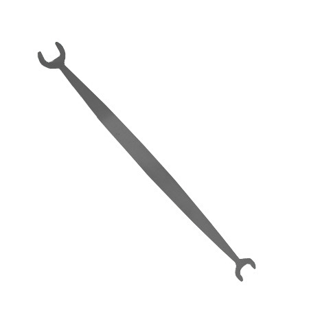

Thanks Plodder and Chris.
Hell’s Bells, my memory is shot as those who know me will confirm!
I seem to remember buying a special and quite expensive spanner and quite a few clips from a Company called Rejel?

It was the p&p that was the killer.Topcat Tomcat wrote: ↑Tue Jul 19, 2022 2:49 pm I seem to remember buying a special and quite expensive spanner and quite a few clips from a Company called Rejel?
So use their eBay store:
https://www.ebay.co.uk/itm/123557593167
Re: A Post Exterior Trim Removal
Wish I had known about the ebay account. P&P with them direct was £10

When I ordered mine, I pointed out that I thought the postage cost was excessive.
The only response was to send me a load more clips!
