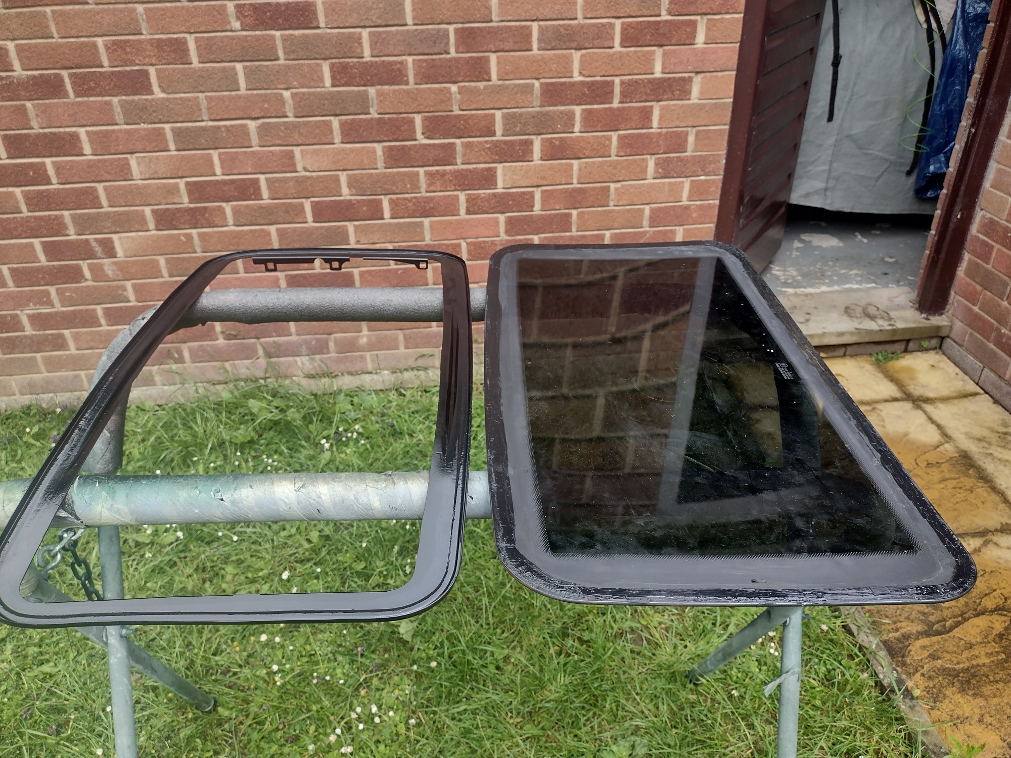

Hi guys, another member has brought me here, I am a well know member on the brm website, and have just signed up to this forum, earlier this year I started making new sunroof frames for the bubble 200's, I also do a repair service aswell as supply the bare frame.

They look fantastic - nice job!
How easy is it to remove the glass and bond to the new frame?
Bennyboy
Posts: 3
Joined: Sat Oct 05, 2024 6:04 pm
Re: R3 Sunroof Seal
Post by Bennyboy »
It's hard to say how hard something is, however I would say majority of people with a degree of ability should be able to do it, some glasses come out easier than other, I would save on average it's takes me 3 to 4 hours just to remove the glass as it's such a tight fitment up against the metal frame however it can be longer or shorter. I have sold 20 frames now with a couple going abroad. I have also built a few up complete for people, they send me the old sunroof and I refurb it and send it you back in a wooden crate I made.
