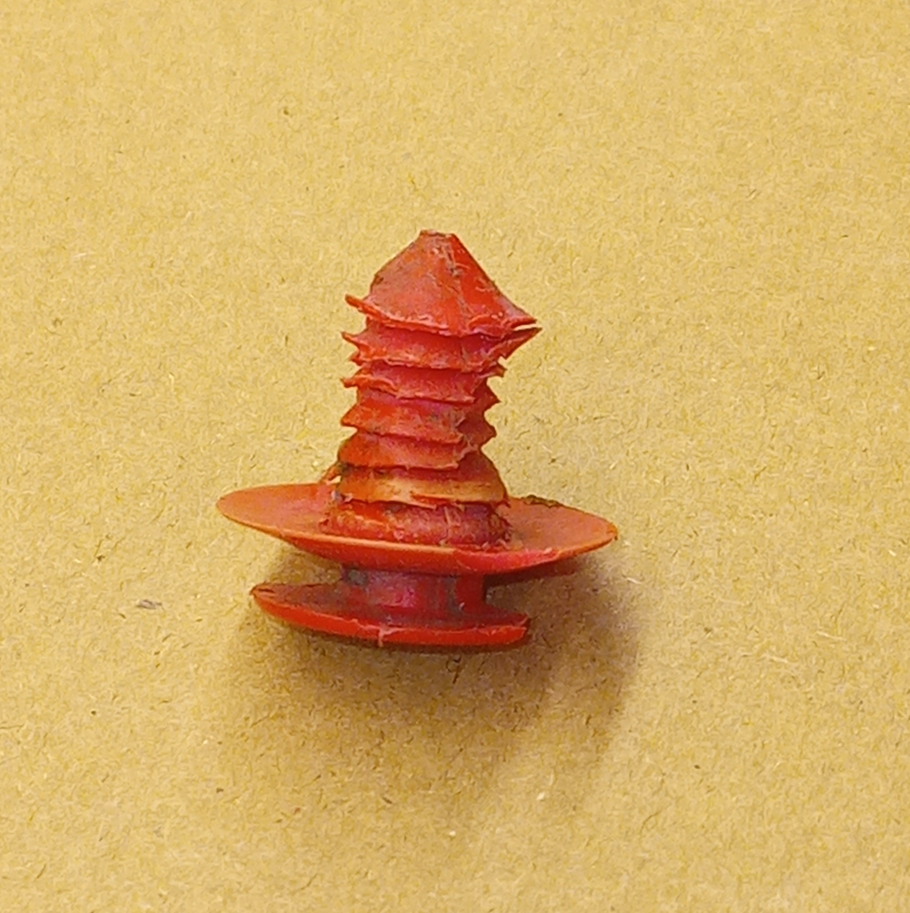

Hi All
TBH I’d expected many to have had to take off the arches, prob due to rust, and broken many clips so was hopeful someone would knw the clip and a source.
But I’ve taken a pic as suggested by GSi, as below.
So hopefully someone know of a source.
PS thats one of the unbroken ones, *laughs*.
Cheers Bean

That looks quite similar to a lot of clips that are used to retain door cards. What are the various dimensions of it (diameters of the two circular parts and also the overall length)? And what diameter is the hole in the wing?

Howard (RIP) used to swear by a company called Bresco for clips like this.

Well now found the part number EKM100270.
So to help if anyone else does a search Streetwise Wheelarch moulding clips part number is EKM100270
Rimmers do them, but i think i'll pass buying from them as at £2.58 PER CLIP PLUS delivery they ate taking the pi55.
So Ebay here we come.
Cheers Bean
