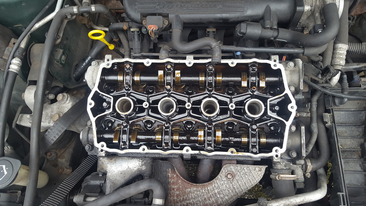

The cam carrier oil leak has gotten much much worse and it is also leaking coolant out the back of the
block, it has also developed a hesitation on start up, we suspected HGF even though we have no mayo
but at least one piston pot is getting coolant inside it, my Cabby didn't have mayo but after the Water
pump failed we checked the original gasket and it was just as well as it was a total failure waiting to
happen.

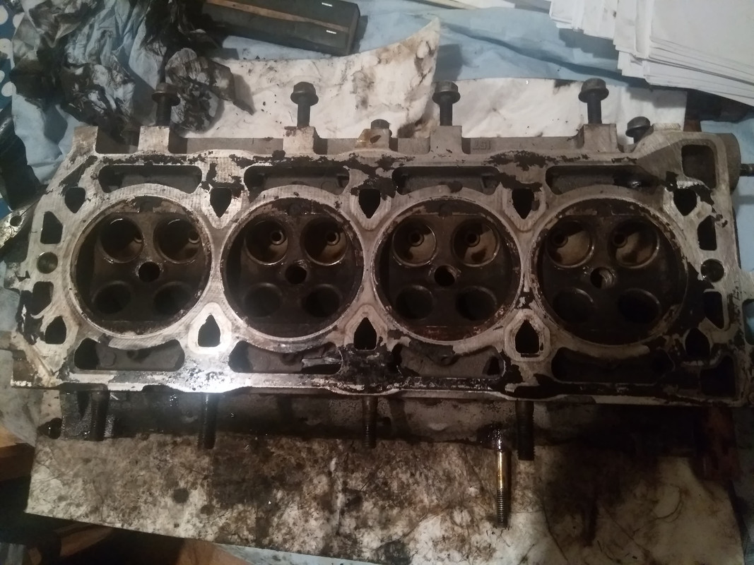

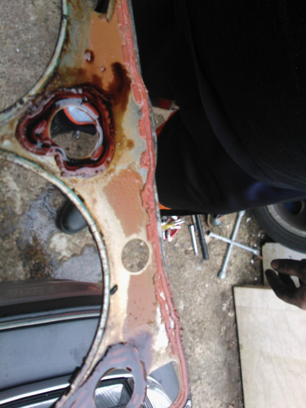

We took off the head on Brian and found it had an MLS gasket fitted but it looked like it was stuck down
with some black gunk or silicone which could account for it not sealing properly, it is also a high possibility
that the head has been off before and this MLS was reused, these things come to test us, but above
all, it is a............

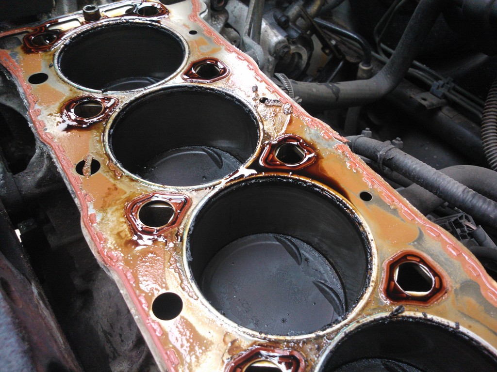

As you can see we had no mayo but pot 1 was filled with coolant before the head came off as we left
it overnight, took the plugs out the next day and cranked it and were greeted to a jet of coolant out
of plug hole 1.

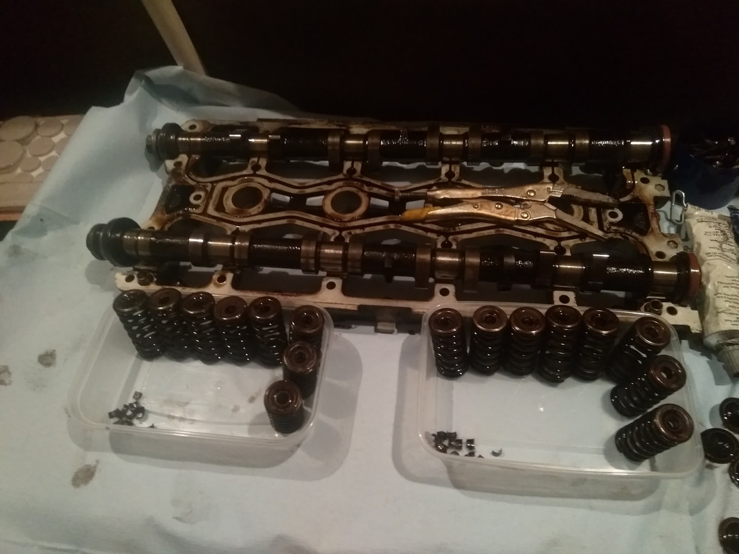

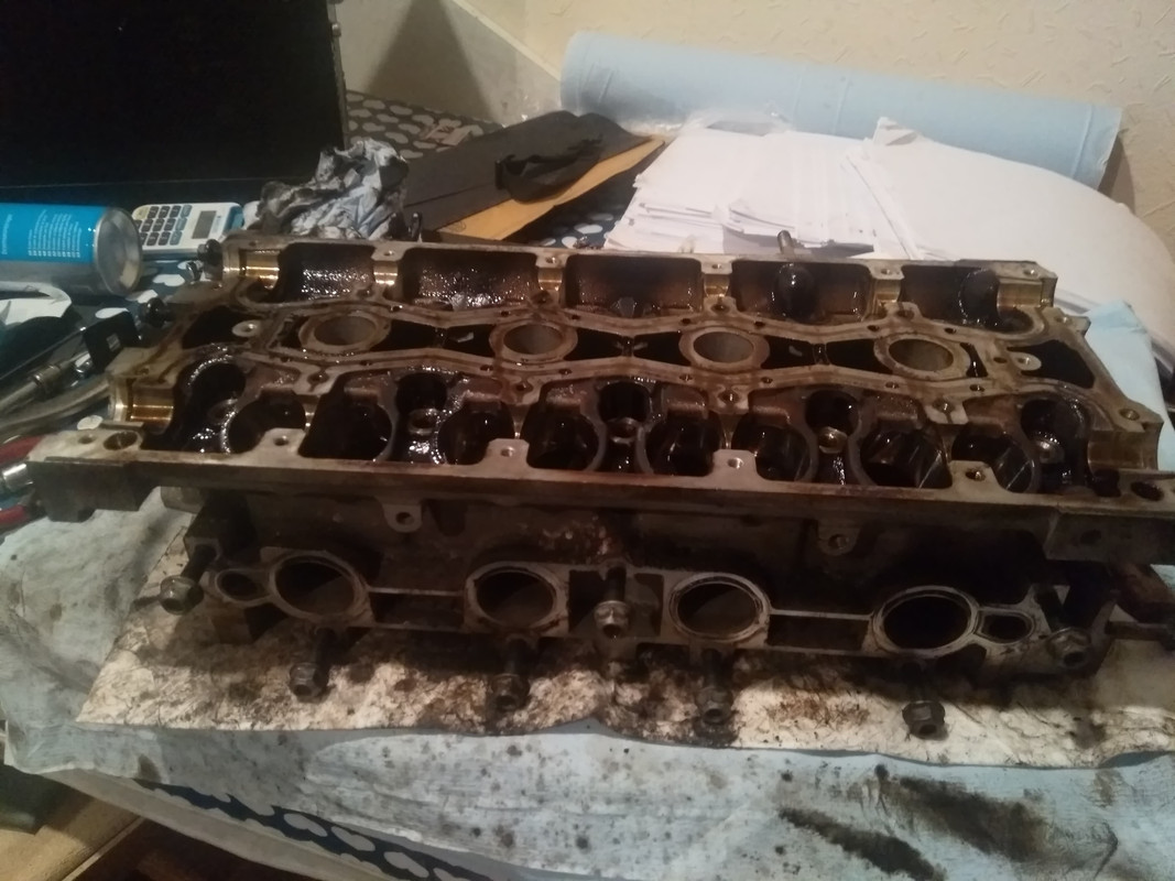

ebay as usual provided a few other odds and ends too but we called it a day and 'The Steve' decided to be
really fastidious and fully strip the head to clean it up and do the valve stem oil seals at home and re-lap
all the valves, I told him not to bother but its like talking to a 6"3' bald Welsh brick wall.
:headbanging :headbanging :headbanging
Here is his progress so far.

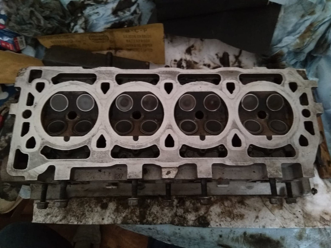

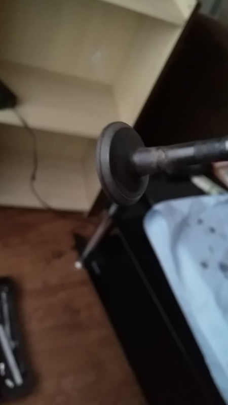

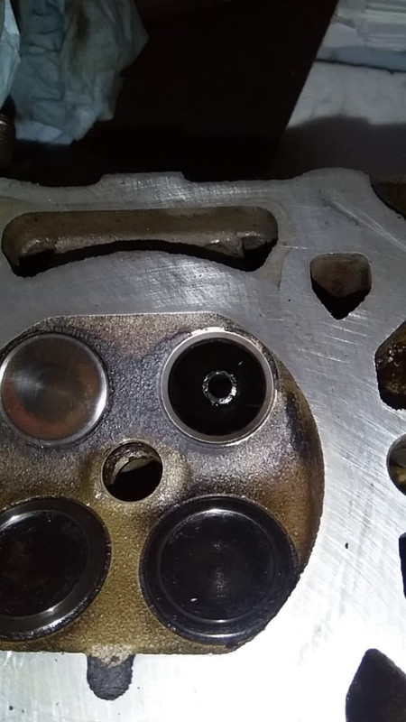

The head was checked for cracks but it has none that 'The Steve' could see, the valve seats are ok but the
exhaust valve seats have a fair bit of putting but it was coming out ok, just taking a little longer than usual.
The face of the head is perfect and it was straight edged and it's flat as Holland.
The head is now ready to go back on the car and we are going to finish all this off on Thursday along with lots
of cups of tea, bacon and egg plus possibly a vat of Curry too, stay tuned next weekend for a follow up and
final progress report, if we get a chance then we will attempt to sort out the faulty radio wiring so at least my
old man can crank up the bass and listen to some sic banging tunes on Radio 4.
:clapping :laughing2 :slapme

Finished cleaning up the block, the surface was lightly sanded and wiped over with brake cleaner, I also got
any oil contamination out the waterways with a syringe, before we finished last week we sprayed and wiped
WD40 in the bores to prevent rust, it had a bonus effect, it lifted up the heavy carbon deposits off the top of
the pistons, quite happy with how it turned out.
Needless to say it got the obligatory thumbs up seal of approval from 'The Steve'. :D

i'm not seeing the shim layer of the gasket there or is it an early pic :S
crepello
Posts: 2047
Joined: Thu Feb 18, 2010 2:47 pm
Location: Mid-Herts
Re: 'Brian' The 25 - Repairs & Update
Post by crepello »
There seems to be quite a loose definition of 'MLS' in general use. Goes with the times, I suppose, there are no longer any absolute truths.
Detail shots of the construction of some MLS gaskets show more than one steel layer, and often the sandwich is united by eyelet rivets through tabs extending front and rear.
The one in this post matches the BGA one I fitted to my rescue job last autumn. That had a single steel layer, conventional crushable fire rings and a pair of outer moulded
elastomer layers. These were bonded, probably by ultrasonic welding, by pinching them together through small rectangular apertures n the steel layer. These are apparent
in the pics above.
I eventually took the view that this was an upgrade of the elastomer design only, over the older narrow beads of elastomer, and fitted it as the instructions for one of those
in respect of bolt torques. I would suppose this would also mean the restrictions on liner height matching would not apply, though mine was an older closed deck engine where
this concern isn't mentioned. Mine's running OK, after a subsequent thermostat problem was sorted, but hasn't come out of hibernation to be stressed on the road yet.
Now that the engine in the pics is clean, it's possible to see the original gasket was fitted the right way up - the small head coolant holes were on the inlet side like the new one.
